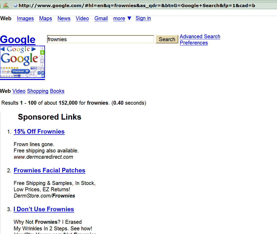

Proxo with 2/13/2009 filters is not filtering Google search on Firefox 1.5 2, and 3 (I have all versions on different computers). Proxo with Sidki's latest filters correctly filters Google search on IE6, IE8, Safari 4 and Opera 10.
On Firefox for the last several days, searches have only had PARTIAL Proxo filtering. I get 100 search results which indicates filtering since I have never allowed Google a cookie so the Proxo fake Google cookie appears to working. But on searches for something that is a popular sale product, I get the Google ads on the right side, at the top and in the center of the page. I also sometimes get a strange Google map on the upper left corner (small square). The font on Google searches sometimes is strange and not my usual Verdana font. Again, this is only on Fx. I always, on any browser, type google.com into the address bar and search directly from the Google search page.
The Proxo menu does not display properly now on Google search pages on any version of Fx. It displays correctly on other browsers.
I don't use the Google Alternate Search Display nor the themes. All other Google filters are used.
.png  Sunday, April 26, 2009 02;02;14001.png (Size: 123.46 KB / Downloads: 769)
.png  Sunday, April 26, 2009 02;04;21001.png (Size: 92.19 KB / Downloads: 808)

I see that too. I didn't see that before because i rarely start a search from the frontpage, see below.
It's apparently Google Search switching to Ajax, which bugger was announcing here:
http://prxbx.com/forums/showthread.php?t...&pid=12068
You can see that from the unusual string you get in the address bar:
http://www.google.com/#hl=en&q=frownies...
I don't know if it can be fixed. Maybe Kye-U has an idea.
However, it does only seem to appear if you enter your search string into a Google form.
I have set up a search engine in Firefox (as well as in Opera, IE) and assigned "go" to it. If i enter "go frownies" into the address bar, i end up with http://www.google.com/search?q=frownies , which displays just fine (for me).

It's the same Ajax script overwriting our own injected style sheet. It seems that this can be fixed generically. Fortunately.
