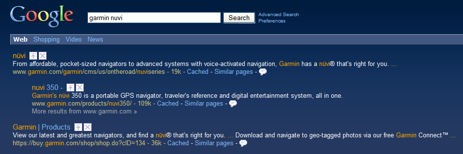

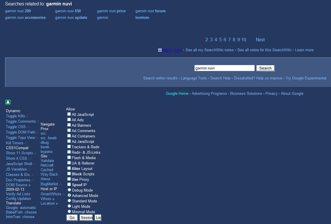

My test result:
(Apr. 26, 2009 06:20 PM)sidki3003 Wrote:  To make the bottom flyover links and the Proxomitron menu work again...
When signed in:
Bottom flyover links didn't show. The Prxomitron menu icon moved to the bottom left. The menu lost its own background color but the menu item function did work.
.png  google_prox_menu.png (Size: 37.97 KB / Downloads: 759)
When signed out:
Both worked well.

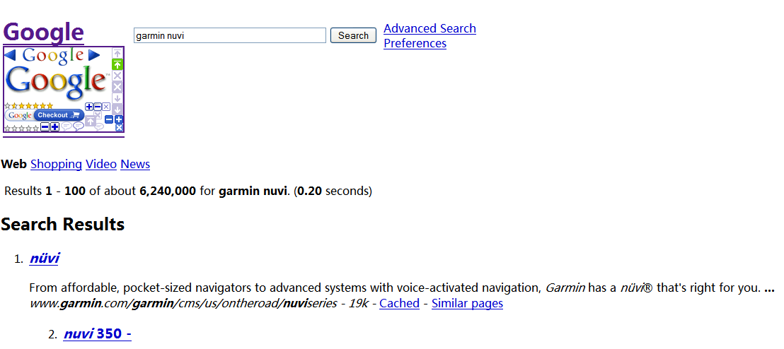

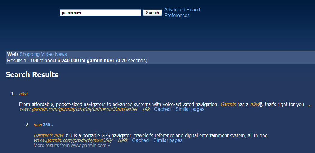

(Apr. 28, 2009 03:33 AM)JJoe Wrote:  Searching with K-Meleon and the # version of Google gets an acceptable page with no numbers, date range box, thumbnails, or modifier links.
No date range box, thumbnails on signed in or out.
Numbers appeared on signed out but disappeared on signed in.
When signed out, google logo, arrows and other image were not shown but would show in one place when toggle css.
When signed out, page looked like zoomed in.
.png  google_signed_in.png (Size: 28.63 KB / Downloads: 735)
.png  google_signed_out_nocss.png (Size: 27.76 KB / Downloads: 779)
.png  google_singed_out.png (Size: 21.18 KB / Downloads: 751)
