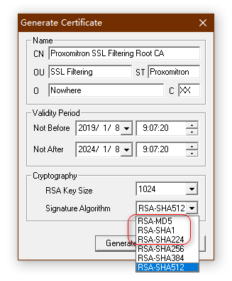

Another suggestion is to remove MD5, SHA1 and SHA224 from the Signature Algorithm drop down menu. They are either not secure any more or not approved for use with publicly trusted certificates. I can also foresee by removing them will also avoid new users complaining their browsers not working with the certificates and blaming it to Proxomitron.
Reference:
  • https://www.sslshopper.com/article-check-ssl-certificates-for-the-vulnerable-md5-algorithm.html
  • https://www.thesslstore.com/blog/difference-sha-1-sha-2-sha-256-hash-algorithms/
.png  hashing algorithm.png (Size: 7.12 KB / Downloads: 635)

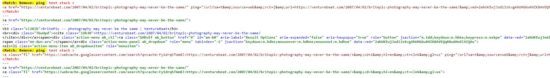

The Replacement Stack doesn't always work correctly.
To replicate:
Name = "Remove: ping  test stack"
Bounds = "<a\s*>"
Limit = 1536
Match = "\# "
        "ping=$AV(*)"
        "onmousedown=$AV(return (clk|rwt|hlprwt) \(*)"
Replace = "---\r\n"
          "\@\r\n"
          "---\r\n"
Enable HTML Debug info
https://www.google.com/search?q=britepic
With Opera, I see:
.jpg  stackerror.jpg (Size: 108.23 KB / Downloads: 624)
<Match: Remove: ping  test stack >
<a href="https://venturebeat.com/2007/04/02/britepic-photography-may-never-be-the-same/" ping="/url?sa=t&amp;source=web&amp;rct=j&amp;url=https://venturebeat.com/2007/04/02/britepic-photography-may-never-be-the-same/&amp;ved=2ahUKEwjJodi3zKvgAhUHG6wKHZK8AVEQFjAAegQIAhAB">
</Match>
<a href="https://venturebeat.com/2007/04/02/britepic-photography-may-never-be-the-same/">
<h3 class="LC20lb">BritePic -- photography may never be the same | VentureBeat</h3>
<br><div class="TbwUpd"><cite class="iUh30">https://venturebeat.com/2007/04/02/britepic-photography-may-never-be-the-same/
</cite></div></a><span><div class="action-menu ab_ctl"><a class="GHDvEf ab_button" href="#" id="am-b0" aria-label="Result Options" aria-expanded="false" aria-haspopup="true" role="button" jsaction="m.tdd;keydown:m.hbke;keypress:m.mskpe" data-ved="2ahUKEwjJodi3zKvgAhUHG6wKHZK8AVEQ7B0wAHoECAIQAg">
<span class="mn-dwn-arw"></span></a><div class="action-menu-panel ab_dropdown" role="menu" tabindex="-1" jsaction="keydown:m.hdke;mouseover:m.hdhne;mouseout:m.hdhue" data-ved="2ahUKEwjJodi3zKvgAhUHG6wKHZK8AVEQqR8wAHoECAIQAw">
<ol><li class="action-menu-item ab_dropdownitem" role="menuitem">
<a class="fl" href="https://webcache.googleusercontent.com/search?q=cache:Fy1drqhTWm8J:https://venturebeat.com/2007/04/02/britepic-photography-may-never-be-the-same/+&amp;cd=1&amp;hl=en&amp;ct=clnk&amp;gl=us" ping="/url?sa=t&amp;source=web&amp;rct=j&amp;url=https://webcache.googleusercontent.com/search%3Fq%3Dcache:Fy1drqhTWm8J:https://venturebeat.com/2007/04/02/britepic-photography-may-never-be-the-same/%2B%26cd%3D1%26hl%3Den%26ct%3Dclnk%26gl%3Dus&amp;ved=2ahUKEwjJodi3zKvgAhUHG6wKHZK8AVEQIDAAegQIAhAE">
</Match>
<a class="fl" href="https://webcache.googleusercontent.com/search?q=cache:Fy1drqhTWm8J:https://venturebeat.com/2007/04/02/britepic-photography-may-never-be-the-same/+&amp;cd=1&amp;hl=en&amp;ct=clnk&amp;gl=us">
The replace for the second match begins with the first stack entry of the prior filter.
This happens on half the matches on that page.
Firefox shows the errors with different code:
<a href="https://venturebeat.com/2007/04/02/britepic-photography-may-never-be-the-same/" onmousedown="return rwt(this,'','','','1','AOvVaw1COy3lz9g2WvLg1QNtXgT-','','2ahUKEwibnurmzqvgAhUIRKwKHRMDD6sQFjAAegQIABAB','','',event)">
</Match>
</cite></div></a><span><div class="action-menu ab_ctl"><a class="GHDvEf ab_button" href="#" id="am-b0" aria-label="Result Options" aria-expanded="false" aria-haspopup="true" role="button" jsaction="m.tdd;keydown:m.hbke;keypress:m.mskpe" data-ved="2ahUKEwibnurmzqvgAhUIRKwKHRMDD6sQ7B0wAHoECAAQAg">
<span class="mn-dwn-arw"></span></a><div class="action-menu-panel ab_dropdown" role="menu" tabindex="-1" jsaction="keydown:m.hdke;mouseover:m.hdhne;mouseout:m.hdhue" data-ved="2ahUKEwibnurmzqvgAhUIRKwKHRMDD6sQqR8wAHoECAAQAw">
<a class="fl" href="https://webcache.googleusercontent.com/search?q=cache:Fy1drqhTWm8J:https://venturebeat.com/2007/04/02/britepic-photography-may-never-be-the-same/+&amp;cd=1&amp;hl=en&amp;ct=clnk&amp;gl=us" onmousedown="return rwt(this,'','','','1','AOvVaw26U9G5DrAC_O9wYNx_ojET','','2ahUKEwibnurmzqvgAhUIRKwKHRMDD6sQIDAAegQIABAE','','',event)">
</Match>
amy

(Feb. 08, 2019 07:42 AM)JJoe Wrote:  The Replacement Stack doesn't always work correctly.
The original Proxomitron shows the same behavior on Win7 and 10.
Dumping the stack to a variable at the beginning of the filter seem to 'fix' this for now.
Note: I only checked Win7 and 10
Edit: Added note
