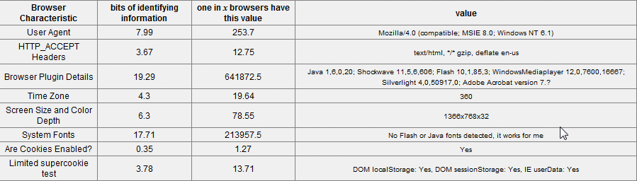

The filter appears to work for me. That is it sets the value of the variable "fonts" and causes the web page to display "No Flash or Java fonts detected" regardless of the browser's settings. The other variables are not modified by the filter.
.gif  panopticlick.gif (Size: 18.79 KB / Downloads: 959)
You may have to beat on IE to make it let go of its cached copy of the external script or your Proxo may be choosing to not filter this external script.
