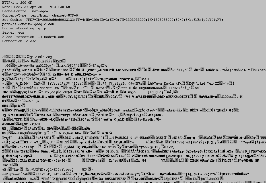

To get the dbug source it was necessary to use the log window because the menu isn't showing up (it does on some sites though)
But the dbug source is monochrome text that looks like gibberish (like an .exe would look in a text editor). Screen cap attached. The log entry is very short - also attached.
Something beyond filters must be causing this. I'm wondering if there's a similar install issue again. I had downloaded a new copy of sidki's config to be sure that no changes I've made were causing trouble, so I don't see how folder names would be a problem. I just added the .exe (and bypass list so that it wouldn't show load errors)

(Apr. 27, 2011 07:53 PM)zoltan Wrote:  To get the dbug source it was necessary to use the log window because the menu isn't showing up (it does on some sites though)
or add ?prx-command=dbug.. to the end of the address.
(Apr. 27, 2011 07:53 PM)zoltan Wrote:  But the dbug source is monochrome text that looks like gibberish (like an .exe would look in a text editor). Screen cap attached. The log entry is very short - also attached.
The Proxomitron exe folder should contain a file named zlib.dll? I think the gibberish is zipped html. Restart the Proxomitron after adding the dll.

(Apr. 27, 2011 08:41 PM)JJoe Wrote:  The Proxomitron exe folder should contain a file named zlib.dll? I think the gibberish is zipped html. Restart the Proxomitron after adding the dll.
http://prxbx.com/forums/showthread.php?tid=1712
This is zlib version 1.25 and the same thing occurs on Windows 98 using it. Gibberish in dbug mode and no menu at google. However, there is no problem with version 1.2.3 available here: proxomitron.info.

That did it. Added the updated zlib.dll. I had been using 1.1.4 from 2002.
It's working fine now, even in the custom config.
