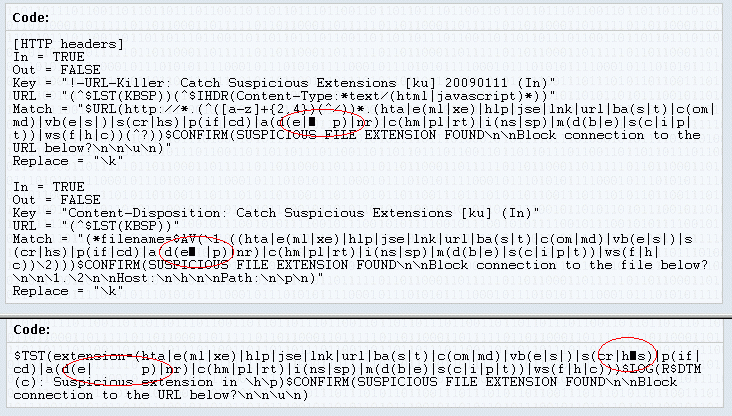

Is it just me or is there odd characters in the filter codes?

Graycode, yes, we are having problems with the strings inside the code tag. Maybe the solution could be forum would not not wordwrap inside code.
Sidki spoke me about URL-parser and the uExt variable. So to be more general, better use $TST(uExt= instead of $TST(extension= in the code of my above post. Edited: 090128 |
