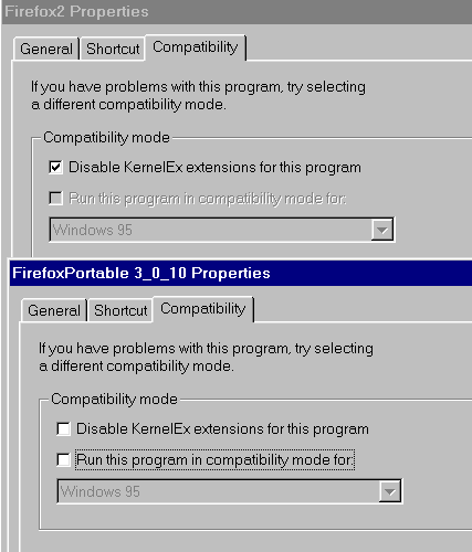

(Jun. 25, 2009 05:12 AM)dave Wrote:  My guess is the problem is my system which is an under-powered Windows 98se and perhaps something to do with transparency which GreenBrowser uses and Win 98 doesn't support.
If you're going to keep that Win98SE then you might want to give KernelEx a shot.
http://www.msfn.org/board/index.php?showtopic=130936
It's a small open-source package that extends many of the low level OS system functions to be compatible with XP and newer software. For example: I did my taxes with TaxCut again this year, and I occasionally use Firefox 3 (as well as Firefox 2). You may get the normal transparency behavior in GreenBrowser (I haven't tried GB).
For any program or shortcut on your PC you can choose whether KernelEx extension is enabled for it or not. It extends the right-click, Properties of Windows Explorer to let you specify. The attached image shows I've disabled KernelEx on my Firefox 2 program, and left it enabled it for a portable version of Firefox 3.
.gif  Win98_KernelEx.gif (Size: 8.33 KB / Downloads: 736)
Jun. 26, 2009, 12:03 AM
RE: Prox Menu and GreenBrowser
Thanks Graycode. Sounds interesting and I may give it a try but this PC is 9 years old so you can imagine how under-powered it is.
