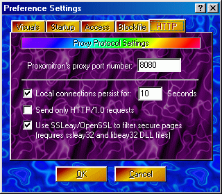

What does this do? Seems to being stopping some sites from loading without refreshing them, only some sites are bad. CloseLocal = false fixes the problems.

That's related to the "Local connections persist for:" option in the "HTTP" tab of the settings dialog.
"CloseLocal = TRUE" is "Local connections persist for:" disabled.

(Oct. 21, 2009 06:12 PM)turtle Wrote:  Seems to being stopping some sites from loading without refreshing them, only some sites are bad. CloseLocal = false fixes the problems.
Have you enabled HTTP/1.1 through the proxy?
It's a browser setting.
.gif  LCP.gif (Size: 44.24 KB / Downloads: 727)

Looks like it got unchecked in the June 6 update, reset it and put time at 40sec--that fixed sites with problem, and yes i had HTTP/1.1 w/proxy set. Thanks Charlie
