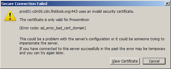

Finally, I got the correct files together and it appears to be working. I'm still getting certificate errors on certain sites. I don't know if these are within the intended scope of the fix. With Proxomitron bypassed, the site renders properly. On https://firstlook.org/theintercept/ I get
SSL error.png (Size: 14.22 KB / Downloads: 817)
With Proxomitron filtering, only the text is visible. |

(Jan. 26, 2015 02:07 AM)herbalist Wrote: On https://firstlook.org/theintercept/ I get This is expected due to the self signed cert that the Proxomitron is giving the browser|client. The browser is expecting the cert to say "firstlook.org" but it says "Proxomitron". It may be possible to set the browser to ignore this mismatch. Which browser are you using? |

RE: Adapting proxo 4.5 to the latest OpenSSL DLLs
Seamonkey 2.0.14, last 98 compatible versions, even with KernelEx.

It has been years since I used Seamonkey. Check "about:config" for something like "security.mixed_content.block_active_content" and set it to "false".
