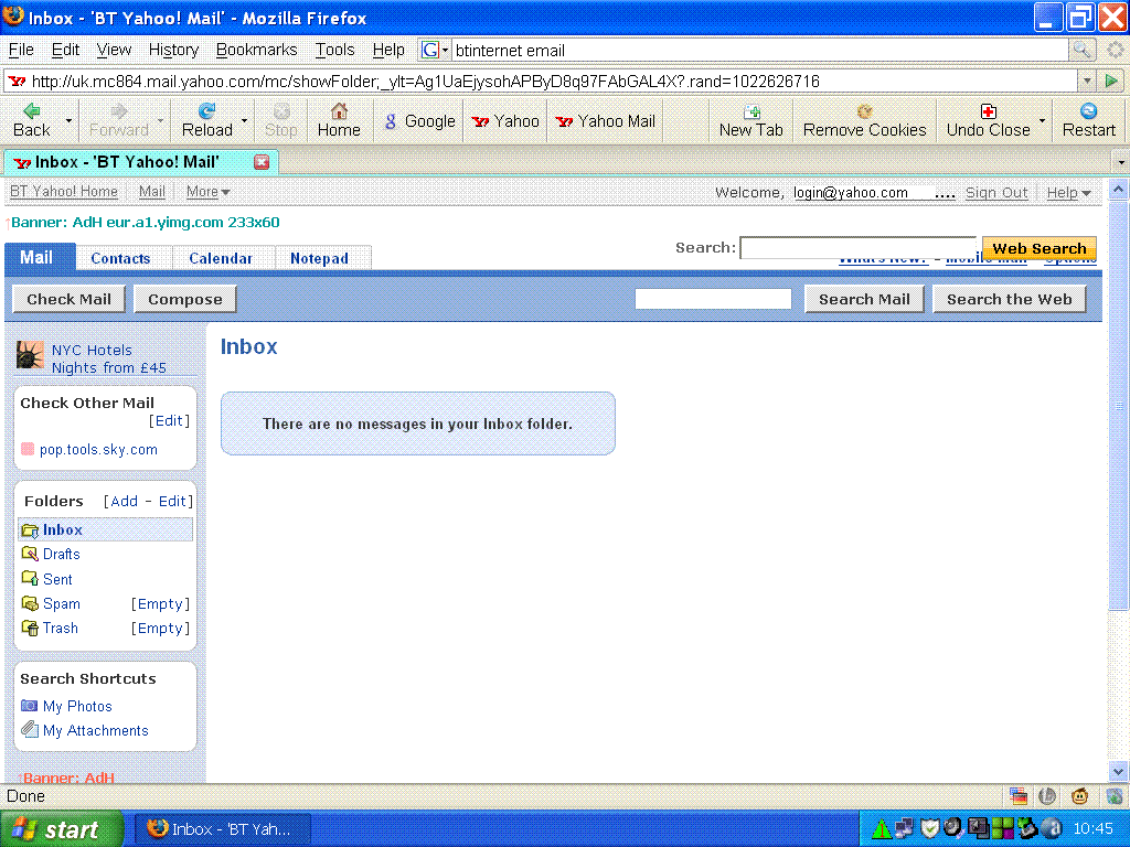

Does anyone know how (and is willing) to adjust/add to Sidki's Yahoo filter(s) to remove the 'search' box at the top right of the webmail pages? For me, this annoyingly partly masks some local links such as 'Options'. I've attached a screen grab of what I see. On that, I have all Yahoo filters turned off and turning any/all on doesn't remove the search elements.
I suppose my experience here might be subject to one or more of the other filters in the config, but I'm assuming it needs a current Yahoo filter updating or maybe a new Yahoo filter for webmail.
Thanks for any help,
Lee

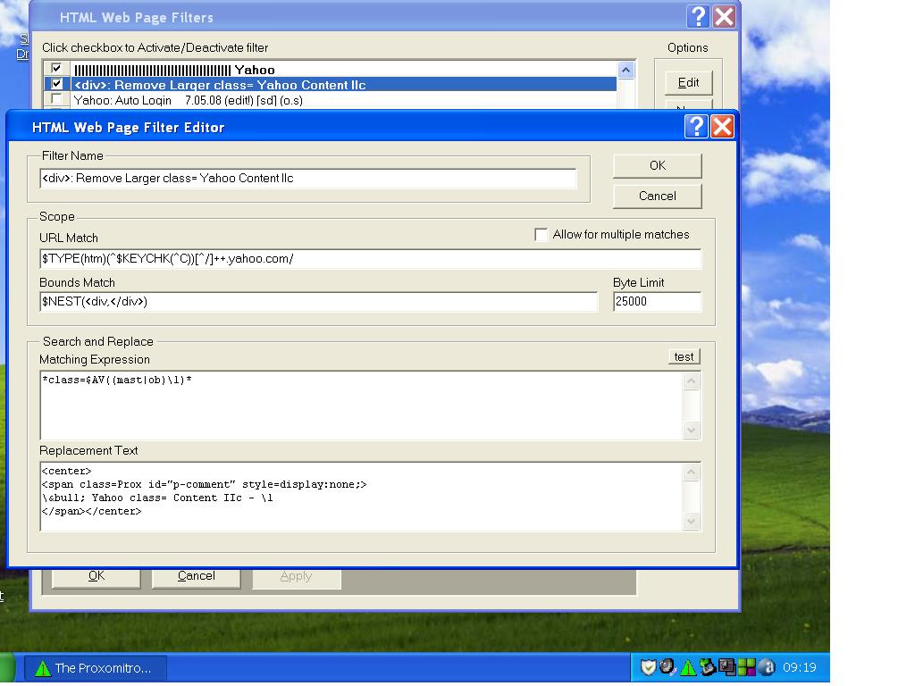

Assuming I've made that filter correctly (I've attached a screengrab) it doesn't seem to be impacting on my issue.

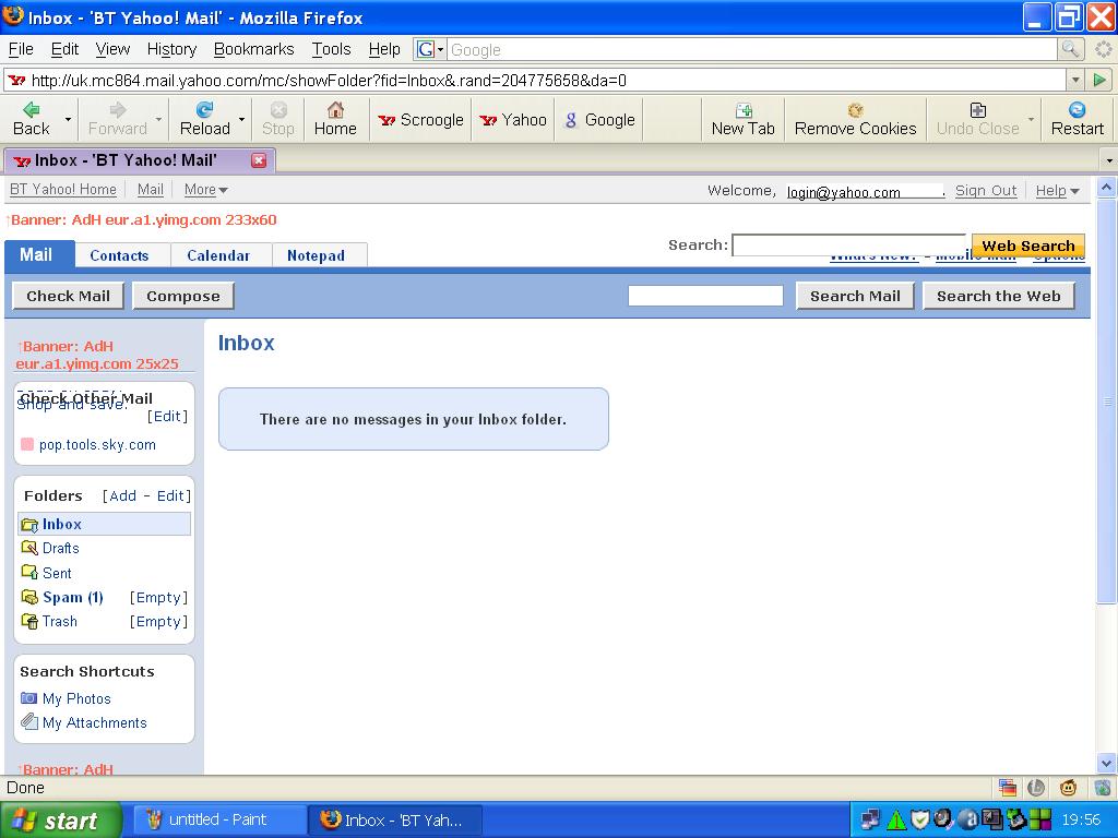

I've noticed my problem is caused by Prox removing content; the page then 'contracts' and that search box ends up where I showed it earlier.

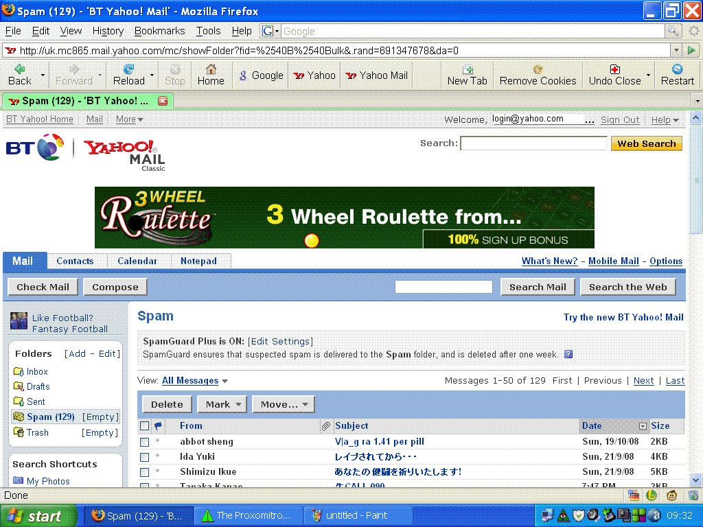

In case it inspires you or anyone else, I've attached a screengrab of the page unfiltered. It seems to be the removal of the 'Yahoo Mail Classic' logo (h**p://eur.a1.yimg.com/eur.yimg.com/a/uk/mail/btyclassic1.gif) that seems to cause the problem. Disabling all the functions under 'Block Ads By URL' doesn't seem to bring it back. (whilst keeping Block Ads By URL itself turned on)

I appear to have 'fixed' this myself. Adding the following to the bottom of IncludeExclude-U.ptxt brings the Yahoo Classic logo back and the search box falls back into its correct position. Luckily (?) no ads seem to be let through as a result of doing this.
*mail.yahoo.com* $SET(0=a_adban.a_adimg.)
I did that using the 'white triangle in a green circle' Prox menu on the webpage, by selecting 'Allow Ad Banners', using 'list' to save it, having made the url generic. I never have (and never will) know how to make such rules manually. All I understand is you can make the matching url generic by bunging a star before and after it.

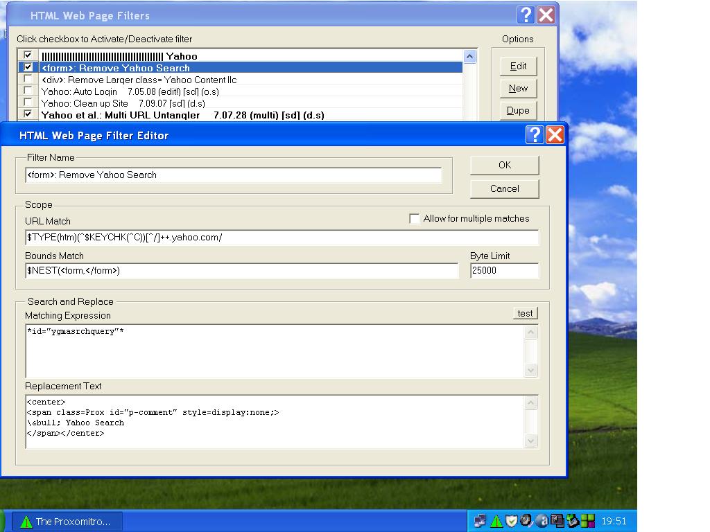

try replacing the id="ygmasrchfrm" with id="ygmasrchquery"...
Sep. 24, 2008, 07:06 PM
RE: [Req] Clean up Yahoo webmail
hmm still no change for me in either IE or Firefox. It increasingly looks like I'm doing something wrong here, doesn't it !
I've attached 2 grabs, one showing my attempt at your (revised) filter; the other showing a resulting Firefox page.
I don't know if the url format is throwing things off here?
