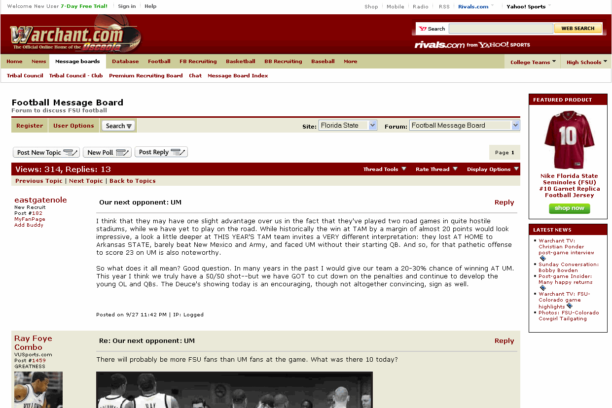

I don't understand why you aren't seeing it. I just tried it again and it's there. Every other post is that color. Here's a screen cap:

you sure that you don't have a filter that is changing that color for you from it's default to your magenta?

Proxrocks you're right, a filter was doing that. I don't understand why though since it's a bright background dimmer that I copied from a forum about 2 years ago. It's never done that before and usually works very well.

Hmmm. I unchecked that filter and it got rid of the magenta. I suppose it could be the conjunction of it and other background dimmers. I still find it strange that I couldn't find the code for that color in the page source or any of the css.
