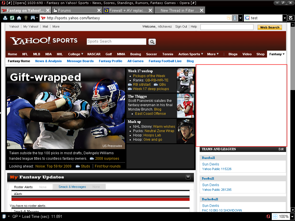

I am using the lates sidki filter set. I have been having a few issue with Yahoo sites for quite a long time now. One issue is that the is a div on my fantasy sports page that I cannot seem to get rid of (there is an image below.
.png  1.png (Size: 404.57 KB / Downloads: 663)

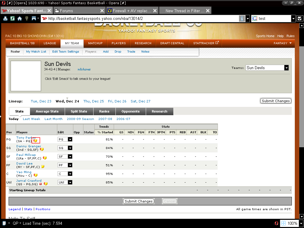

Another ussue with Yahoo fantasy sports is that certain pages are not allowed to use popups regardless of the E-U entry. Again, it is pictured below; whe a player has recent news about then users clock on the image and then a inline popup opens. That never hapens.
.png  2.png (Size: 152.49 KB / Downloads: 639)

(Dec. 25, 2008 03:22 AM)n8chavez Wrote:  One issue is that the is a div on my fantasy sports page that I cannot seem to get rid of.
Try adding below entry in AdKeys-S.ptxt.
sports.yahoo.com/        $SET(sAdKey=.lrec_loader.)$SET(sAdKeyR=<!--hide-->)
(Dec. 25, 2008 03:22 AM)n8chavez Wrote:  Another ussue with Yahoo fantasy sports is that certain pages are not allowed to use popups regardless of the E-U entry.
It seems have to sign in to see that page, so I am sorry...
