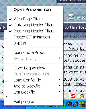

This is by no means anything new, but sometimes, such as now, I feel the need to try and find a fix. Previously without success.
Do any of you find in XP (or used to and now have a fix), that when you right-click on some tray icons, you often also get the XP Taskbar context menu opening? I do, on Prox and some other tray icons, and is moderately annoying. The result looks like the attached screen grab. Sometimes / usually I find the 2 menus almost merge with each other, meaning I have to click on the desktop and Taskbar to clear them both, then try again.
I don't know if it something to do with mouse/click accuracy, although I have not yet found a solution.
I also wonder if it is some kind of byproduct of working my XP Display at 'Large Size 120 dpi', but I have not reached a conclusion on this.
Thanks for any thoughts and fixes,
Lee
.gif  context-menu.gif (Size: 15.34 KB / Downloads: 823)

Hello eclipse and thanks for replying.
I seem to recall previously that didn't work, but maybe I hadn't actually tried it. Anyway, I just have and rebooted and the problem remains.
I also just tried un-ticking 'lock the taskbar' (back on 120 dpi) and that seems to remove the problem.
I could 'live' with that, but I have however just found a workaround, which disables the XP right click taskbar context menu. ie now, it cannot open at all but the context menus on applications still can.
I only really use the taskbar context menu to access the Task Manager, so I'll just add a shortcut to that elsewhere.
The workaround I did is a registry change; you add or change an existing DWORD value at the following location :-
HKEY_CURRENT_USER\Software\Microsoft\Windows\CurrentVersion\Policies\Explorer
In right-side pane, have DWORD "NoTrayContextMenu" present and set to 1
Lee
