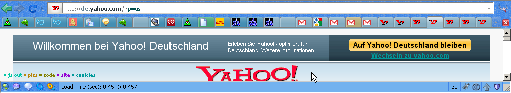

Jan. 25, 2009, 04:49 PM
RE: Yahoo! Mail
No, unfortunately not, see screencap. Removing it is simple, but then non-US people have no chance to get to _www_ yahoo.com.
Btw: While checking, i realized that a JS error, "document.getElementById("sethomepage") is null", which is bugging me for months, can be fixed by replacing...
adlrec|eyebrow|ks-ypn-ads|marketplace|mantlecx|minimantle|news-sponsor|nns|northad|southad|spnsr
|spons[oe]red*|srec|swads|ws_ie7|yat(gad|ad_*)|ydireast|yfi_pf_(ad*|ysm)|ygmatop|ymadbn
|ymap(clad|ead|nad|west|footer)[0-9]+|mastheadhd$SET(2=<div style="line-height:7px">&nbsp;</div>
<div id="mastheadhd" style="display:none"><br id="sethomepage" /></div>)
...with...
adlrec|ks-ypn-ads|marketplace|mantlecx|minimantle|news-sponsor|nns|northad|southad|spnsr
|ymap(clad|ead|nad|west|footer)[0-9]+|eyebrow$SET(2=<div style="line-height:7px">&nbsp;</div>
<div id="eyebrow" style="display:none"><br id="sethomepage" /></div>)
...IOW, updating the "eyebrow" fix.
