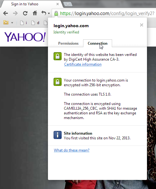

(Nov. 23, 2013 10:38 PM)ProxRocks Wrote:  how did you track down yahoo = digicert
The browser showed me
.png  yahoo.png (Size: 84.13 KB / Downloads: 378) .
I used a direct connection to load yahoo, clicked on the lock, clicked on Connection. Then I compared the old "certs.pem" to the new and found the new certificates. Searched google for info about the new certs. Finally, I removed the new certs and lost the alerts.
However, the plan is, there still are Digicert certificates in certs.pem that are used to verify connections.
