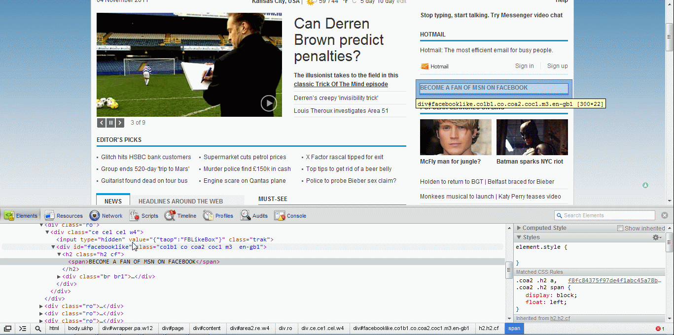

(Nov. 04, 2011 08:49 PM)scoop Wrote:  Also JJoe if you dont mind me asking please could you explain in an "easy way" how you found the facebooklike code for AdKeys.ptxt. ?
In ChromePlus, Opera, or Firefox with firebug, I right click on the page, select "Inspect Element", and quickly see
.gif  HowI.gif (Size: 145.62 KB / Downloads: 414) .

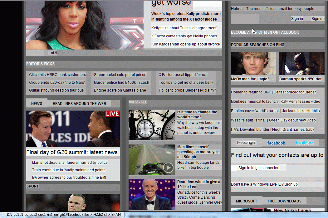

Otherwise:
If the browser has a status bar, sidki's menu has a toggle for the DOM path and Topo view. After DOM path is enabled, the path for the element under the cursor may be displayed in the status bar.
.gif  HowI2.gif (Size: 227.69 KB / Downloads: 428)
