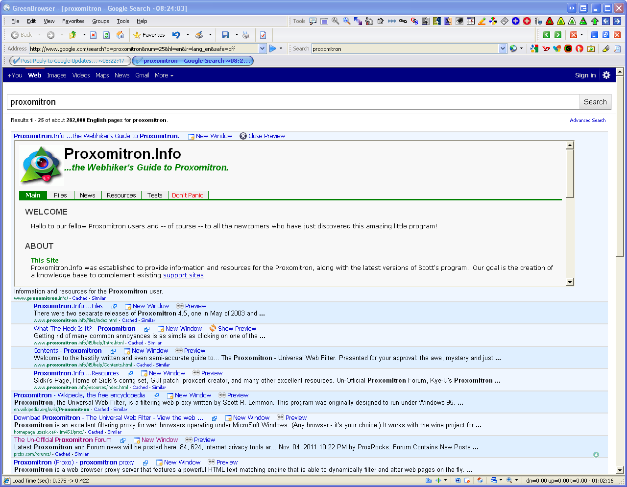

here are the Google Search filters that i am now using...
i use a "preview" feature (opens search results in an iframe within the same page instead of opening a new browser tab or window) that was first introduced by JD5000 and was never officially incorporated by sidki...
first off, these no longer require the ". + Google Toggle: Left NavBar" filter and it should be un-checked (disabled)...
these filters axe the NavBar and having "two" filters targeting the NavBar probably just introduces "risk" of them not 'playing well with others'...
the other sidki, jjoe, et alia Google filters maintained by the Proxo Community should be kept in place ("Google: Convert Results: xslt.us & newverhost.com", "Google: Cached Header Mover", "Google: Multi URL Untangler", "Google Search: Remove Ad Blocks", "Google Search: Fix Shortcuts", "Google Books/Groups: Remove Ad Blocks", "Google Images: Direct Links")... be sure to un-check (disable) the other "theme" filters, of course... also un-check (disable) the infor bar, left bar, and logo theme-filters that are floating about (if you have them, you know the one's i'm referring to - these are not abandoned, per se, they are incorporated directly into my "theme")...
these are not 'tested' with the "Google Search: Add Modifier Links" filter that 'comes with' sidki's config and is enabled by default as i disable that one for my own preference - i do not know if it "interferes" with my theme or not, to be honest... i'll let anybody that decides to use my theme report findings on that front...
okay, "intro" / "disclaimers" aside, lol...
here is the first filter that you will need to add...
i have it placed directly beneath "Header Top Add: User JS Code on sel. Sites" in the "||| Pre-Body" section...
you only need this if you want the "preview" function that JD5000 used to use...
Name = "Header Top Add: User JS Code - Google Preview [add]"
URL = "(^TYPE(oth))www.google."
Limit = 16
Match = "(^(^<ProxHdrTop>))$STOP()"
Replace = "\t<script type="text/javascript">//<![CDATA[\r\n"
          "\t function GooglePrv(Gid,Gsrc,Glid,Gplid) {\r\n"
          "\t \r\n"
          "\t prxO.oInt.inToggleB(Gplid,'id','a',1);\r\n"
          "\t prxO.oInt.inToggleB(Glid,'id','a',1);\r\n"
          "\t prxO.oInt.inToggleB(Gid,'id','div',1);\r\n"
          "\t \r\n"
          "\t var Giframe = document.createElement("iframe");\r\n"
          "\t Giframe.setAttribute("src", Gsrc );\r\n"
          "\t Giframe.setAttribute("width", "95%" );\r\n"
          "\t Giframe.setAttribute("height", "300px" );\r\n"
          "\t \r\n"
          "\t document.getElementById(Gid).appendChild(Giframe);\r\n"
          "\t }\r\n"
          "\t \r\n"
          "\t function GooglePrvC(Gid,Glid,Gplid) {\r\n"
          "\t \r\n"
          "\t \r\n\t }\r\n\t//]]></script>\r\n"

a screen-cap is also attached for reference...
.zip  html.zip (Size: 4.7 KB / Downloads: 945)
.png  11-13-2011 8-25-07 AM.png (Size: 120.58 KB / Downloads: 1053)

Dec. 25, 2011, 01:55 PM
RE: Google Updates...
@ProxRocks: Can we use these filters with the new prox-config-sidki_2011-12-22rc1 posted by jjoe. Any caveats?
soccerfan
Dec. 25, 2011, 02:55 PM
i'm currently staying at mom and dad's for Christmas so i'm kinda limited with testing the rc1 because this machine is on Win 7...
yes, Proxo and everything works on Win 7 - BUT I DOWNRIGHT HATE VISTA/7!!!
that coupled with an "old people computer"...
working right now on creating registry files for my preferences versus the parents' so i can bring the system to "my standards" and "their standards" just by clicking a .reg file and logging off/on...
you know, like the d@mn high font DPI that "old people" use but is just downright INSANE for anybody that can actually SEE, lol... (the high DPI messes up Proxo's GUI, at least my 'patched' GUI...)
Dec. 25, 2011, 03:46 PM
(Dec. 25, 2011 02:55 PM)ProxRocks Wrote:  i'm currently staying at mom and dad's for Christmas so i'm kinda limited with testing the rc1 because this machine is on Win 7...
Merry Christmas. And good luck on your reg files Smile!. I'll stay tuned.
soccerfan
Dec. 30, 2011, 01:28 PM
i'm looking to 'finally' get to this later today or so...
Dec. 30, 2011, 07:24 PM
everything still works, no changes required...
reminder, the alternate display presented in this thread is NOT intended to work with the three color themes that come with the sidki config...
so if you want the "preview feature" of my theme, you'll have to change the even/odd/background colors to fit your own color preference...
Dec. 30, 2011, 10:37 PM
(Dec. 30, 2011 07:24 PM)ProxRocks Wrote:  everything still works, no changes required...
Sounds good.
Quote:the alternate display presented in this thread is NOT intended to work with the three color themes that come with the sidki config...
So, we use them with your 'tight blue' theme, right?
Thanks and HNY Smile!
soccerfan
