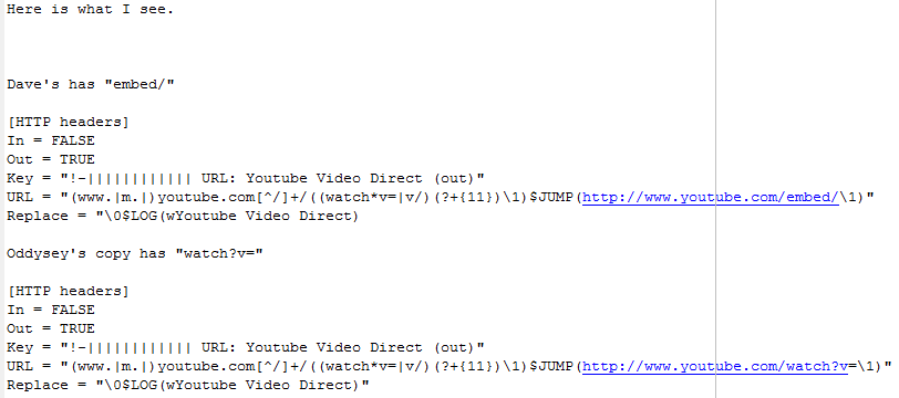

Nov. 26, 2013, 02:04 AM
RE: Youtube video direct and Get youtube download url
Oddysey, I don't think you understood. I wasn't talking about testing the filters at Youtube.
The filter in the cfg that you posted is not Dave's posted filter. Where your filter has "watch?v=" Dave's has "embed/".
I speculated that something at your end is modifying Dave's posted filter.
Disable all your filters and load a fresh page here at TUOPF before you read Dave's post.
Attached is an image to show what I see, Dave's filter and yours. I have proxo bypassed.
.png  diff.png (Size: 16.89 KB / Downloads: 926)
