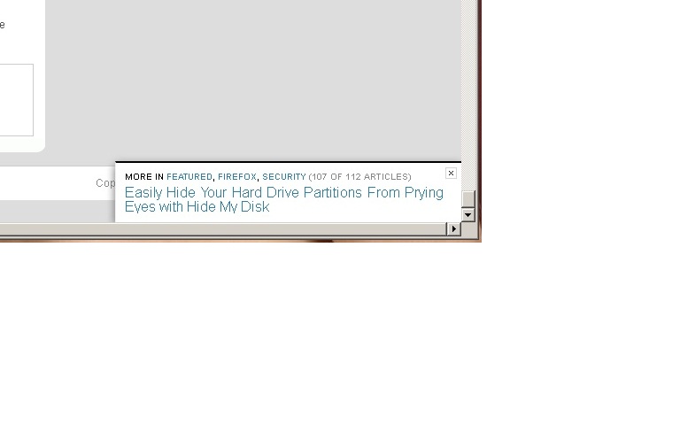

Hi can someone please post a filter to block these ad's which moves in from the right hand side at the bottom when you scroll down.?
like on this site for example.
http://www.vikitech.com/686/top-18-firef...b-tracking
I have added Attachment screenie as well.
.jpg  side.jpg (Size: 29.63 KB / Downloads: 670)

Try
Name = "vikitech slide in"
URL = "$TYPE(htm)www.vikitech.com"
Limit = 2560
Match = "<div id=$AV(upprev_box)*<!-- #upprev_box -->"
Replace = "<!-- PROX #upprev_box REMOVED-->"

(Aug. 07, 2012 03:42 AM)arran777 Wrote:  are you able to post a filter for all websites? because those slide in type ad's are becoming very popular on the internet now.
I think you are using the filters that come with the Proxomitron aka Scott's set?
"upPrev" appears to be a WordPress plugin, http://wordpress.org/extend/plugins/uppr...in-button/ .
I suspect most site will use some generic version of it. So, a generic web page filter that targets the box (like already posted) might remove this "feature" from many other sites.
The script is http://www.vikitech.com/wp-content/plugins/upprev-nytimes-style-next-post-jquery-animated-fly-in-button/upprev_js.php?ver=3.4.1 . So, you could (or also) target keywords in a typical address with a web filter
Name = "Remove upPrev wordpress plugin"
URL = "$TYPE(htm)"
Bounds = "<script*</script>"
Match = "*/upprev_js.php*"
AND/OR a header filter
Key = "! : RDIR: block upPrev"
URL = "*upprev_js.php"
Replace = "Killed\k$LOG(!RGET $DTM(c) : upPrev blocked URL: \u)"
None of the above addresses slide-ins like but not upPrev. As ProxRocks says, javascript provides many ways to do/hide these things. I don't see common code to target without consequences.
My (sidki's) set controls timed events with a button that appears near the bottom of the page. I must click this button to see the upPrev box. Not easily added to Scott's set.
For the sidki set, http://prxbx.com/forums/showthread.php?tid=1870
My opinion, all ads can't be blocked with out disturbing content and not all upPrev boxes are ads. upPrev will be left to the "Timer" button or the user.

Actually I have just found that it is not impossible to block the side bar ad's without completely blocking java script.
I am using Sidki ruleset but his rules don't have any rules to block the side bar ad's. But I have just found out by using the original proxomitron default install rules in web page filters the rule called
"Stop Java Script Timers" blocks the side bar ad's.
confirmed on these 2 other sites as well with the ad box sliding in from the bottom right hand side as your scroll down.
http://www.everydayhealth.com/digestive-...ction.aspx
http://pandithnews.com/2012/08/09/assad-...emier.html
I shell add the "Stop Java Script Timers" rule to Sidki's ruleset
problem solved.

sidki's default set-up already blocks those...
you should see a "timer" button in the lower left corner - click on that "timer" button and the ads will slide in...
but by default, the ads are BLOCKED, the java script timer is "disabled" until the user clicks on a button...
if i were you, i'd remove the "Stop Java Script Timers" rule and find out why your sidki config isn't doing what it is supposed to do by default, you've disabled something that was enabled by default...
