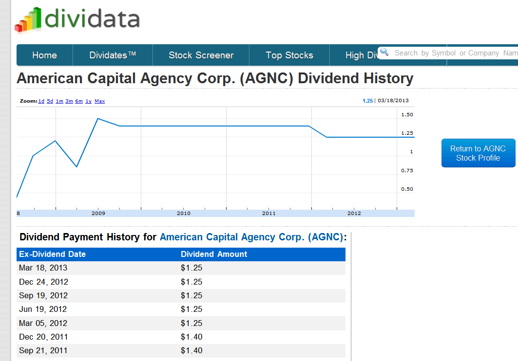

I would like to display a flash graph by default (without having to press "Toggle" button each time) on this page: http://dividata.com/stock/AGNC/dividend

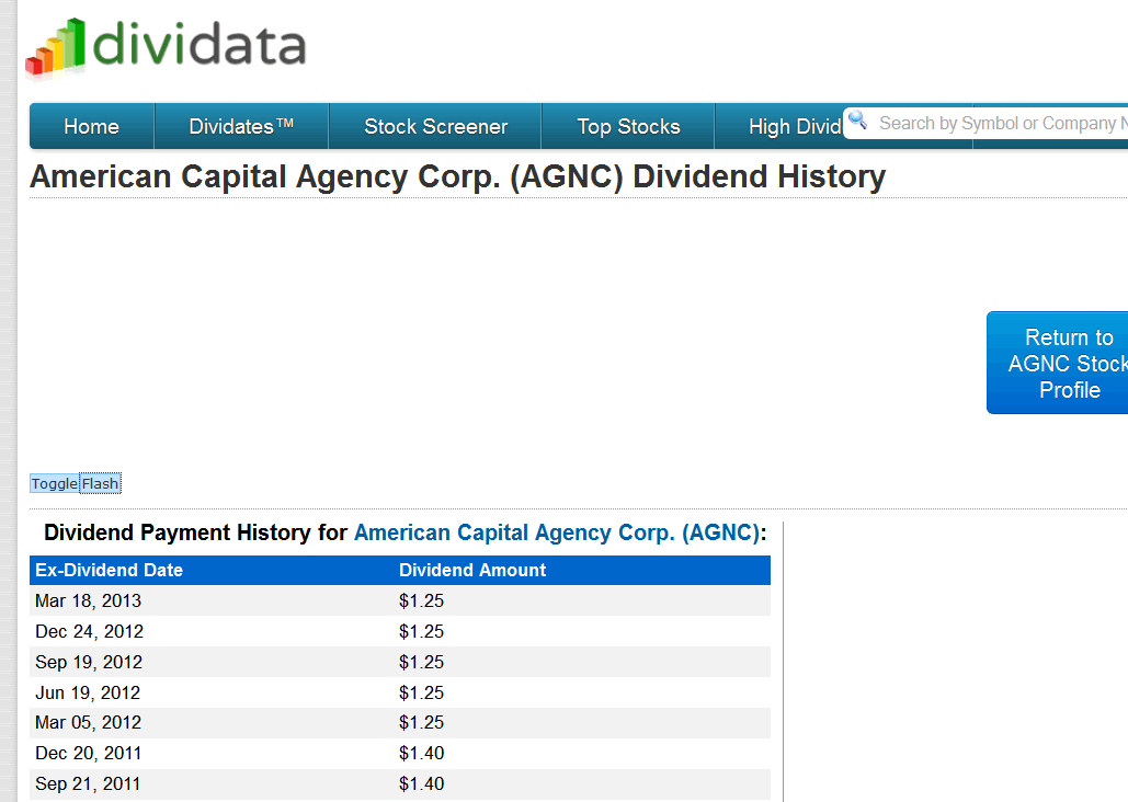

It should look as on "graph_displayed.gif" attachment, and I always have the button displayed instead ("button_to_graph.gif").
I have this entry in Exceptions-U:
dividata.com/stock/     $SET(0=a_js.)
which gives me the button, but I cannot find an entry to get rid of the button and directly display the flash graph.
These do not work:
dividata.com/stock/     $SET(0=a_js.a_flash.a_embed.)
www.gstatic.com/charts/        $SET(0=a_js.a_flash.a_embed.)
.gif  graph_displayed.gif (Size: 35.92 KB / Downloads: 297)
.gif  button_to_graph.gif (Size: 32.08 KB / Downloads: 317)

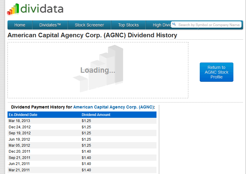

It works for me, but only if I untick header filter "! |||||||||||| 7.2 Block all Third Party Scripts 10.10.16 [sd] (o.3) (Out)"
If that filter is ON, the page doesn't load totally, it stops before displaying the graph (see picture attached).
I tried "a_js.i_script:0." :
[^/]++www.google.com/ & $OHDR(referer: http://dividata.com/stock/)    $SET(0=a_js.i_script:0.a_flash.)
www.google.com: & $OHDR(referer: http://dividata.com/stock/)    $SET(0=a_js.i_script:0.a_flash.)
but that doesn't do anything.
Only turning off Block 3d-party scripts allows full loading of the graph.

.gif  incomplete_loading.gif (Size: 26.01 KB / Downloads: 337)

That is what I would expect. Had I know you had enabled it I would have included: also add
dividata.com/stock/  $SET(0=i_script:0.)
to Exceptions-U.
The dividata page is requesting scripts from google (google is then a "third party" to dividata)
(o.3) tells us the filter is user enabled (o for optional) and might cause problems (3).
The "Block all Third Party Scripts" problem is shown by
<Match: <script> Block: All Third Party Scripts     10.10.19 (cch!) [u sd] (d.0) >
<script src="https://www.google.com/jsapi" type="text/javascript">
</Match>
on http://dividata.com/stock/AGNC/dividend?...and=dbug..
