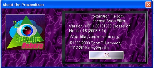

As a side-note, you can check the version of Proxomitron you're using in the Help->About of the main dialog. Proxomitron Reborn will clearly show that in the About dialog.

(Feb. 23, 2020 06:55 AM)amy Wrote:  As a side-note, you can check the version of Proxomitron you're using in the Help->About of the main dialog. Proxomitron Reborn will clearly show that in the About dialog.
Thank you, Amy. I attached a photo of the Help —› About of the main dialog in my Proxomitron and this is what it says. Hope it is uploaded. I also want to thank you for everything you do to keep this little gem of a program running. You are appreciated greatly.
