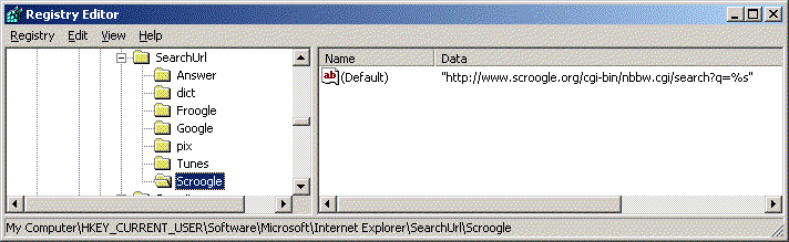

So, is all of this worth any more effort? I dunno, but what I can tell you is that there is an even easier answer, one that is guaranteed to work, at least for IE. Whazzat?, you ask. Easy, it's an entry in your Registry. You might not know IE supports an Alias feature all on its own, sans Proxo. You merely have to type in the alias that you've previously setup, enter any parameters such as search terms, and off goes IE, merrily bringing back your query's results. In the Registry, navigate down to CurrentUser/Software/Microsoft/Internet Explorer/SearchURL, and make a new key. Set the default value to the search engine's address, and use the characters %s as the search parameter that will be filled in on the address bar. I've attached a screen capture of my entry for Scroogle.
While I desire to know more intimately what goes on underneath the hood of my browser, it's not important to me that I accomplish a mission in one particular way. So long as I can get the results I want, then I'm happy. Whistling Smile! If anyone can make the filter work without the need for hyphens, great, I'll check it out. Short of that, I'll continue to use the Registry entry with no qualms.Pray
p.s. Registry key names can be any length, including one character. I just like full names for clarity. Also, what you type in the address bar is case-insensitive, google and Google yield the same results.
.gif  scroogle_key.gif (Size: 23.05 KB / Downloads: 904)
